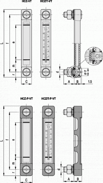

Kolumnowe wskaźniki poziomu ze śrubami montażowymi z SUPER-technopolimeru HCZ-VT
Produkt | f | d | A | B | C | L | e | m | r | d'%-0.2% | C [Nm] |
HCZ.254/T-P-VT-M12 | 254 | M12 | 23.5 | 17.5 | 29 | 284 | 203 | 25 | 15.5 | 12.5 | 6 |
HCZ.254-PT-VT-M12 | 254 | M12 | 23.5 | 17.5 | 29 | 284 | 203 | 25 | 15.5 | 12.5 | - |
HCZ.127/T-P-VT-M12 | 127 | M12 | 23.5 | 17.5 | 27 | 156 | 80 | 23 | 14.5 | 12.5 | 6 |
HCZ.127-P-VT-M12 | 127 | M12 | 23.5 | 17.5 | 27 | 156 | 80 | 23 | 14.5 | 12.5 | - |
HCZ.76/T-AR-PT-VT-M1 | 76 | M12 | 23.5 | 17.5 | 27 | 105 | 40 | 18 | 14.5 | 12.5 | 6 |
HCZ.76-P-VT-M12 | 76 | M12 | 23.5 | 17.5 | 27 | 105 | 40 | 18 | 14.5 | 12.5 | - |
HCZ.254/T-VT-M12 | 254 | M12 | 23.5 | 15 | 24 | 278 | 203 | 25 | 12.5 | 12.5 | 6 |
HCZ.254-VT-M12 | 254 | M12 | 23.5 | 15 | 24 | 278 | 203 | 25 | 12.5 | 12.5 | - |
HCZ.127/T-VT-M12 | 127 | M12 | 23.5 | 15 | 22 | 150 | 80 | 23 | 11.5 | 12.5 | 6 |
HCZ.127-VT-M12 | 127 | M12 | 23.5 | 15 | 22 | 150 | 80 | 23 | 11.5 | 12.5 | - |
HCZ.76/T-AR-VT-M12 | 76 | M12 | 23.5 | 15 | 22 | 99 | 40 | 18 | 11.5 | 12.5 | 6 |
HCZ.76-VT-M12 | 76 | M12 | 23.5 | 15 | 22 | 99 | 40 | 18 | 11.5 | 12.5 | - |
